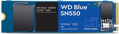

My question is: Can my system, described below, boot to an SSD installed using a PCIe card? My goal is to have a clean Windows 10 operation system on an SSD.
Here are the details.
-system model: HP Compaq elite 8300 SFF
-system bios: HP K01 v02.86 (HP website shows no further upgrade)
-running: Windows 10 pro x64 on internal SATA hard drive (healthy status)
-NEWLY INSTALLED SSD: Western Digital 1TB WD Blue SN550 NVMe Internal SSD - Gen3 x4 PCIe 8Gb/s, M.2 2280, 3D NAND, Up to 2,400 MB/s - WDS100T2B0C
-INSTALLED ON:  M.2 NVME to PCIe 3.0 x4 Adapter, M.2 NVME SSD to PCI-e 3.0 x 4 Host Controller Expansion Card, Supports 2280, 2260, 2242, 2230 Solid State Drives
-ADAPTER plugged into mother board.
*When I boot my system to the internal SATA drive, the WD SSD is viewable in Windows Explorer, device manager, etc and from the WD Dashboard.
*Using Microsoft utilities, I have installed a clean copy of Windows 10 on the WD SSD.
*Next, shut down. Unplug internal SATA. Boot into BIOS and set BOOT ORDER to UEFI, USB HARD DRIVE.
*Power up system: WILL NOT BOOT
I have tried booting with all BIOS options (listed below) and still WILL NOT BOOT.

That's a NVMe-Drive. Probably your mainboard doesn't support to boot from a PCIe-Slot.

yea, I’m coming to the same conclusion. I have gone through all the bios settings, one at a time and I still get error messages.
bios manufacturers should provide updates but like lots of older stuff, it got dropped.
To bad because as I read online, PCIe/SSD are much faster than SATA/SSD. That said, SATA/SSD much faster than SATA. I believe all 2.5” internal are SATA/SSD, Guess thats ok. Shame cause otherwise its a good solid machine, i5 with 16GB RAM.
I think WD owes me an exchange on this!  Or HP, cause of their **bleep**ty bios.
Have you tried booing from clover? Google clover boot loader. It should let you get around HPs limitation. We'll I hope it does because I just purchased your same setup.
