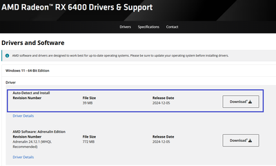

All right, this is what I would do:
Download the AMD RX 6400 driver from here -don't install it just yet
Link: https://www.amd.com/en/support/downloads/drivers.html/graphics/radeon-rx/radeon-rx-6000-series/amd-r....
Next, download and run this freeware utility program called DDU ("Display Driver Uninstaller") which can be downloaded from here: https://www.guru3d.com/download/display-driver-uninstaller-download/.
If you are not quite sure how to run it, please see this YouTube instructional video: https://www.youtube.com/watch?v=jxwDPu_hOD4&t=39s&ab_channel=RobeytechLive.
Once you have run DDU, install the RX 6400 driver.
