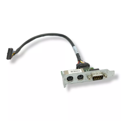

Hi.  I would like to install Windows 7 x64 Pro onto an EliteDesk 400 G5.  I added USB drivers to a Win 7 image, but still no mouse or keyboard.  I have a PS/2 keyboard, so, would this part add PS/2 compatibility to the desktop?
HP 400 600 800 G3 PS2 Serial Port Card Low Profile 910324-001 910110-001
 Thank you in advance for any assistance.
That device does seem to give the PC the additional inputs for PS/2 , however you can/should be able to do the same thing with one of these.
https://www.amazon.com/UCEC-Mouse-Keyboard-Converter-Cable/dp/B00X9QX9MS/ref=sr_1_8?dib=eyJ2IjoiMSJ9...
I do not know how much that device is but the solution given is less than $15.

Hi and thanks.  I ended up buying the part, and it worked great for the keyboard.  I will have to get a PS/2 mouse at some point.  Appreciate you looking around, but the problem is that USB does not work at all on these machines when trying to install Windows 7.  It's the installer for W7.  It doesn't have a driver for USB 3.  I was actually quite surprised that this part worked, but still unhappy, because the W7 installer is not seeing drives, either.  I am back to the drawing board, but that is fine.  Again, really appreciate your help.  Just glad I managed to get the keyboard working for now.  Any progress is good progress.
Looking at the EliteDesk 400 G5 again.  It came with Windows 10 Pro and does have USB 3 with no USB 2, which Windows 7 does not understand the USB 3.  It may also have a M.2 256 GB PCIe® NVMe™ SSD, which might be the reason Windows 7 does not see the drive.
i notice there are SATA ports which may support a SATA drive to get Windows 7 started.  There is also a PCIx slot which might be able to support a USB expansion card for USB 2.0, but there could be other problems with the newer hardware vs what Windows 7 can support.  Perhaps there would be someone on the forums that can give advise for installing Windows 7 on this newer hardware.

The PC was listed as having no drive.  No NVME inside, unfortunately.  I had attached an SSD and then I tried a standard SATA 3.0 drive.  I think I have a SATA 2.0 drive somewhere I might try, however.  Funny you should mention the PCI USB.  I actually have a PCI-e x1 SATA riser, which I tried, but, curiously, it did not help for this application.  However, I can get as far with the installation media as seeing the blank drives dialog, so I did order a dual port PCI USB header.  The installation dialog asks me to install drivers, so maybe I can put the drivers for NVME and USB 3.0 on a USB flash stick and install them using PCI USB 2.0 header.  I know i have the NVME driver, and I should be able to find USB 3.0 support out there somewhere.
Thankyou very much for assisting.  I have looked around for some input about installing Windows 7 on this PC, and I can see it is a tall order to say the least.  I may just install Windows 10 and see if I can work backwards once the USB card arrives.  Thanks again.
