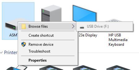

My old HP (p6803w) died so I bought another (570-p013wb) from WalMart.  I had 2 hard drives in the old one..one just for backing up media (was NOT my main drive). I'd like to add this drive to the new computer but I'll admit it: I'm lost. There's no extra connections like the old computer had to plug in a 2nd drive so I bought a USB cable (SATA data & power combo 7+15 pin) that connects to the hard drive thinking that would be easier-but the new computer doesn't ''see''' any files on the old drive (using the USB 3.0 port which is supposed to be enough to power it too).
Under 'Browse Files' it's just grayed out:

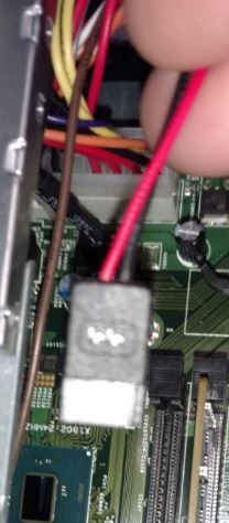

A small update. I disconnected the data cable from the DVD drive and that fits the old drive, but the power cord is different (the newer one is much, much smaller). They are 2 seperate beings and not one big wide plug-in like my old drive takes. Would this adapter be what I needed? There are so many adaptors to choose from..what is something specific I should search for?

Can you post a digital image of the power connector that went to the DVD drive?

I bought a data/powered USB cord that allows the drive to be attached externally but I still can't see my files...would the case be a better solution?
