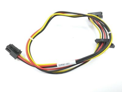

Yes. SSD devices were designed to use the same connections as HDD devices -- 100% compatibility is a good selling-point.
> Also, I can’t see them getting powered by the PSU,
Some computers have a special cable, as shown below, to connect directly to the motherboard, and to have standard SATA power-connectors.
Power from motherboard to SATA devicesPower from motherboard to SATA devices
Thank you! I have both wires you are showing me photos of, the last one connect via the mother board like you said.
should I assume that I could install an extra SSD then?
@Svealf -- should I assume that I could install an extra SSD then?
Yes, but note the short distance between the two SATA connectors in the image that I posted.
For that cable, the "extra" device needs to be physically located close to the first device.
But, that image is only an example of a "special" cable.
Other cables may have more connectors, or the connectors will be further apart.
Note that there are "Y-shaped" cables. The "bottom" of the "Y" connects to a SATA power-connector, and the two "tops" of the Y offer two SATA power connectors, thus allowing two SATA devices to receive power.
