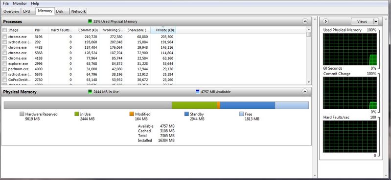

I believe they are being detected because it does recognize there is now 16gb of the new memory, after replacing the one that came with the desktop. I put one of the new ones in where the original was and another in the same channel. My desktop has the blue black blue black configuration. So i have both of the new ones in the blue. Also if this helps in anyway, a majority of the remaining memory is being put into hardware reserved as shown in the picture. And I have tried going through solutions to fix it such as unchecking the maximum memory box in msconfig. I don't know a lot about computers so i apologize if I'm not getting what you are saying

Then you are okay. But your PC is only showing usable memory at 7.19 GB. I don't believe there are any BIOS settings to fix this.
AMD systems use a lot of memory for video but the amount your system is consuming is very high.
I don't know why this is happening.
The first memory usage report you posted shows how Windows is using the installed memory:
Cached
In Use
Standby
Available
Hardware Reserved is 9019 MB. This is extremely high.
It did show 16384 MB installed at the bottom of the report.
