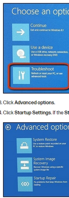

Bad driver or file corruption.  See if you can boot into windows safe mode
https://support.hp.com/bg-en/document/ish_5000477-5000532-16
Once you get into safe mode bring up the device manager and look for any errors and try to repair them.  Typically the driver needs to be rolled back to the previous one or simply  delete the device that has a problem and then reboot.
Alternately instead of figuring out what went wrong, once you get into the safe mode then select the options that restores to a previous time when you knew the PC was working.
If that F11 key does not get you into system recovery then try turning the power on and off three or more times in a row.
When you get to advanced options select 'System Restore"
If f11 does not get you into system recovery then try turning the power on and off three or more times in a row.
When you get to advanced options select 'Startup Repair'
