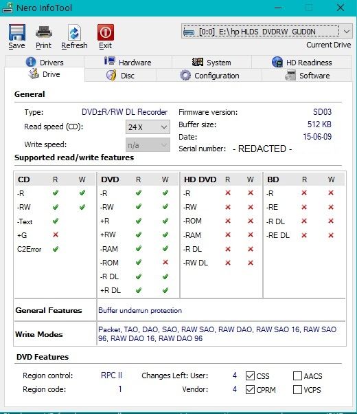

I've used the Nero Info Tool in the past to see what my PC's DVD drive is capable of doing.

As I wrote the other day, the Nero Info Tool will provide everything you ever wanted to know about the drive.

Thank you.  I found and ran Nero info tool. My drive DOES support DVD+R DL discs which Nero DOES confirm is the current disc in the drive.  Interestingly, it was initially recognized as 'an unsupported disc type' which required me to 'skip' the 'speeds test.'  So something is definitely not right; but what is it?  ..suggestions please.

I just installed a regular DVD in the drive, and it ran the test.
