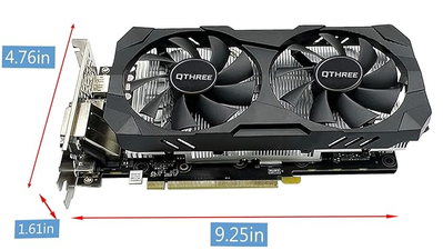

@DivinexBlessing,
All right, see if these RX 580 dimensions (especially the 4.76in height) would fit in your PC:
Link: Amazon.com: QTHREE Radeon RX 580 Computer Video Graphics Card,8GB,2048SP,GDDR5,256 Bit,3X DP,HDMI,DV....
Kind Regards,
NonSequitur777
Might be slow what am I measuring to ? Like from both sides of the case ?
This is the dimensions of my current gpu so would it fit ?
