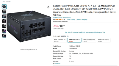

Yes, you can game at 60fps+ in 4K with this option:
1.) Upgrade your power supply with at least a 750-watt power supply such as this Cooler Master MWe Gold V3 750 Watt:
Link: https://www.amazon.com/Cooler-Master-Efficiency-Connectors-Semi-fanless/dp/B0D68TLYKR/ref=sr_1_1?cri....
Happens to be on sale too at the moment.

to be quite honest i was avoiding Nvidia due to the price, i preferred AMD due to the price to performance.
not only this but isnt the rtx 4080 for pcie gen 4?
So i would not get the full capabilities of such a gpu.
