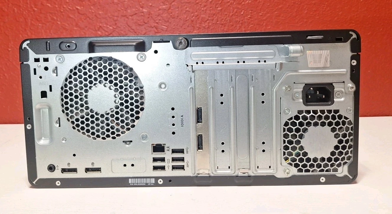

Hp 600 g6 mictotower
Can the HP 600 G6 Microtower 180W power supply be upgraded to a 700W power supply with 80+ Bronze ce

Your HP ProDesk 600 G6 Microtower can easily be upgraded with a smaller-sized 550-watt (p/n: M09864-001) or 500-watt (p/n: 901759-013) power supply, but the thing is that a compatible 700-watt power supply with p/n: L80662-002 / M09027-003 is larger-sized, and even though your PC case has sufficient room (height) to make this power supply fit, your case does not show additional mounting holes to secure this power supply -there would only be one mounting hole (left bottom) to secure the 700-watt power supply.
I suppose you could drill two additional mounting holes up in the back of your case to better secure this power supply, but such mods are frowned upon from the 'official' HP point of view, and you should only consider this if you can do this safely and responsibly.
