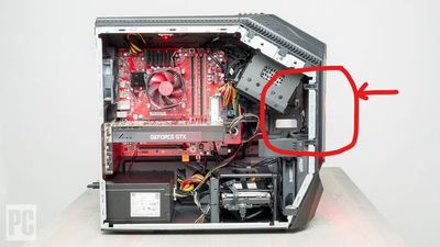

Does anyone know what mm fan would fit in the top intake?

you can see it here
https://partsurfer.hp.com/partsurfer/?searchtext=2XB53EA&searchby=product
probably
928149-001
Fan - System Fan
120 mm

I meant the opposite side , across that one. There is one already (120mm) and space for another
