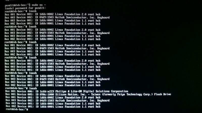

Additional tests have helped me to reveal a functioning that I do not explain. I attach to the message the screenshot of "lsusb" output on Linux. This command lists all USB devices connected to the machine, and details the USB bus to which each device is attached. Here are the results of the command, when it is reiterated with different USB devices connected to the machine, at the front or at the back.
  • A USB device, other than Mass Storage, attached to one of the two rear ports on the left is supported by bus #3;
  • A USB device, other than Mass Storage, attached to one of the two rear ports on the right is supported by bus #2;
  • A USB device, other than Mass Storage, attached to one of the two front ports is not supported at all; it is seen on none of the USB buses.
  • A USB Mass Storage device, attached to one of the two rear ports on the left is supported by bus #1;
  • A USB Mass Storage device, attached to one of the two rear ports on the right is supported by bus #1 too;
  • A USB Mass Storage device, attached to one of the two front ports is supported by bus #1 too.
So,  on this machine, it actually seems that:
  • the USB bus #1 is dedicated to supporting only Mass Storage devices; it catches all devices of this type, regardless of the physical port to which they are plugged;
  • the USB ports on the front panel (aka the internal 9-pin connector on the motherboard) are not wired to any other USB bus than the #1.
This configuration seems very unusual to me. Could it be a limitation of the motherboard itself? I doubt it. Is this a BIOS-specific "feature" of this machine? Without any way of setting it up? That also sounds weird.
Would it be worth trying a downgrade to older versions of the BIOS?
NB: Note that the same phenomenon can also be observed on Windows.
lsusb command output on HP D530lsusb command output on HP D530
