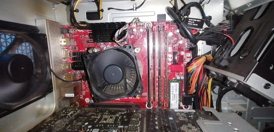

I attached photos to get a better idea of my ​​the setup.
According to your instructions, I am thinking about upgrading to the following:
  • I9-9900K
  • SSD 990 PRO 2TB
  • Corsair Vengeance 3200 MHz 4 x 8 GB
  • RTX 4080
Now I have some doubts:
  1. Do I need a cooler for the 9900K? What is the best option for my setup?
  2. How can I understand if the 4080 fits inside my case?
  3. Given what I intend to upgrade, which power supply can I choose?
Thank you for your help

1.) In terms of your heatsink, an i9-9900K's fairly modest 95-watt TDP should not necessarily be an issue for your existing heatsink. You could consider upgrading your heatsink, but that would mean some effort on your part since most aftermarket heatsinks require removal of your motherboard in order to install a brand-specific heatsink bracket on the bottom-side of your CPU socket.  Looks like you got plenty of space to allow heatsinks such as this example to fit, but this is something you'll have to try out.
2.) The Samsung 990 PRO is a great choice, though expensive.  Please be advised that you'll only reach Gen3 I/O speeds out of this Gen4 drive. To save money and also get a quality 2TB M.2 drive, consider this option: Amazon.com: Western Digital WD_BLACK 2TB SN770 NVMe Internal Gaming SSD Solid State Drive - Gen4 PCI....
3.) Corsair Vengeance RAM presents a mixed bag, with many HP Users reporting that this RAM gets stuck at its default ("SPD") 2400 MHz speed. However, your experience may vary, and it will run just fine.  If you do buy this RAM, purchase it via Amazon so that if this RAM doesn't perform as well, you can return it and get your money back.  Here are some other RAM options I know work generally well on HP desktops: Kingston Fury Beast 32GB (4x8GB) 3200MHz DDR4 CL16 Desktop Memory Kit of 4 KF432C16BBK4/32 at Amazon..., or this: Timetec 32GB KIT(4x8GB) DDR4 3200MHz (or 2933MHz or 2666MHz) PC4-25600 Non-XMP CL22 1.2V Non-ECC Unb....
4.) The RTX 4080 is a big graphics card (between 30cm to 36cm long), and it would mean you'll have to do some 'modding' in your PC, such as having to remove the GPU support bracket I can see in your case.  You'll have to do some measuring to see what will fit best.  Also, I would recommend a 750-watt power supply to power this card.

About the GPU I had to measure and the 1070 that is there is about 26 cm wide, and taking out the support bracket it is possible to put a GPU that goes up to 36 cm, the question is the weight of a 4080 without this support, could it be a problem?
Finally, which PSU do you recommend for this entire system?
thank you
@manzas_,
Outstanding questions:
1.) Yes, it would be a problem, and I would definitely use one of these graphics card support stands:
A.) Amazon.com: Graphics Card GPU Brace Support, Video Card Sag Holder Bracket, GPU Stand, Anodized Aero...
B.) Amazon.com: Graphics Card GPU Brace Support, Video Card Sag Holder Bracket, GPU Stand, L : Electroni...
 (see if 12cm (4.7 inches) is sufficient to reach your graphics card).
