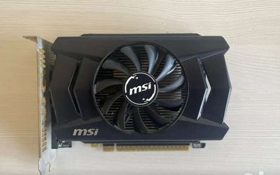

Would this work? Msi one?
No, that one is too tall to fit in the 4000 Pro low-profile case.
Plus, those are the mounting brackets used in a standard tower PC, not a SFF.

With a SFF PC, you must use a low-profile card with a low-profile mounting bracket.
The card you want to buy is a standard profile graphics card with a standard tower size PC mounting bracket.
The card you want to buy will NOT fit in a low-profile PC. It is too tall, and the mounting brackets are too long.
