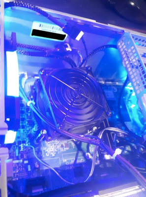

And double-stacking CPU heatsink cooling fans -assuming it will fit in an SFF case: https://h30434.www3.hp.com/t5/Desktop-Hardware-and-Upgrade-Questions/Upgrading-an-HP-Pavilion-TP01-3...:
DISCLAIMER: Due to the complexities involved, proceed with caution when attempting to upgrade the cooling system in your HP EliteDesk 800 G8 SFF.  Also, HP does not recommend, endorse or approve of any case modifications as shown.  Proceed with all due caution and accept personal responsibilities for any damages or injuries you may incur.
For a visual example of a similar upgrade, you might find this video helpful: https://youtu.be/UfIL7x1reDM.
