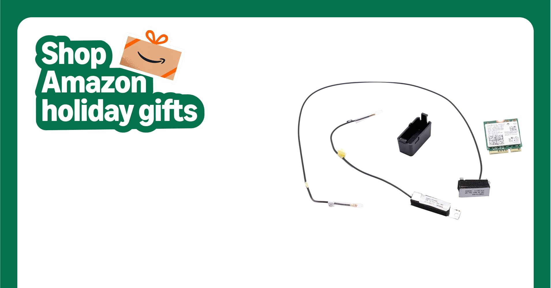

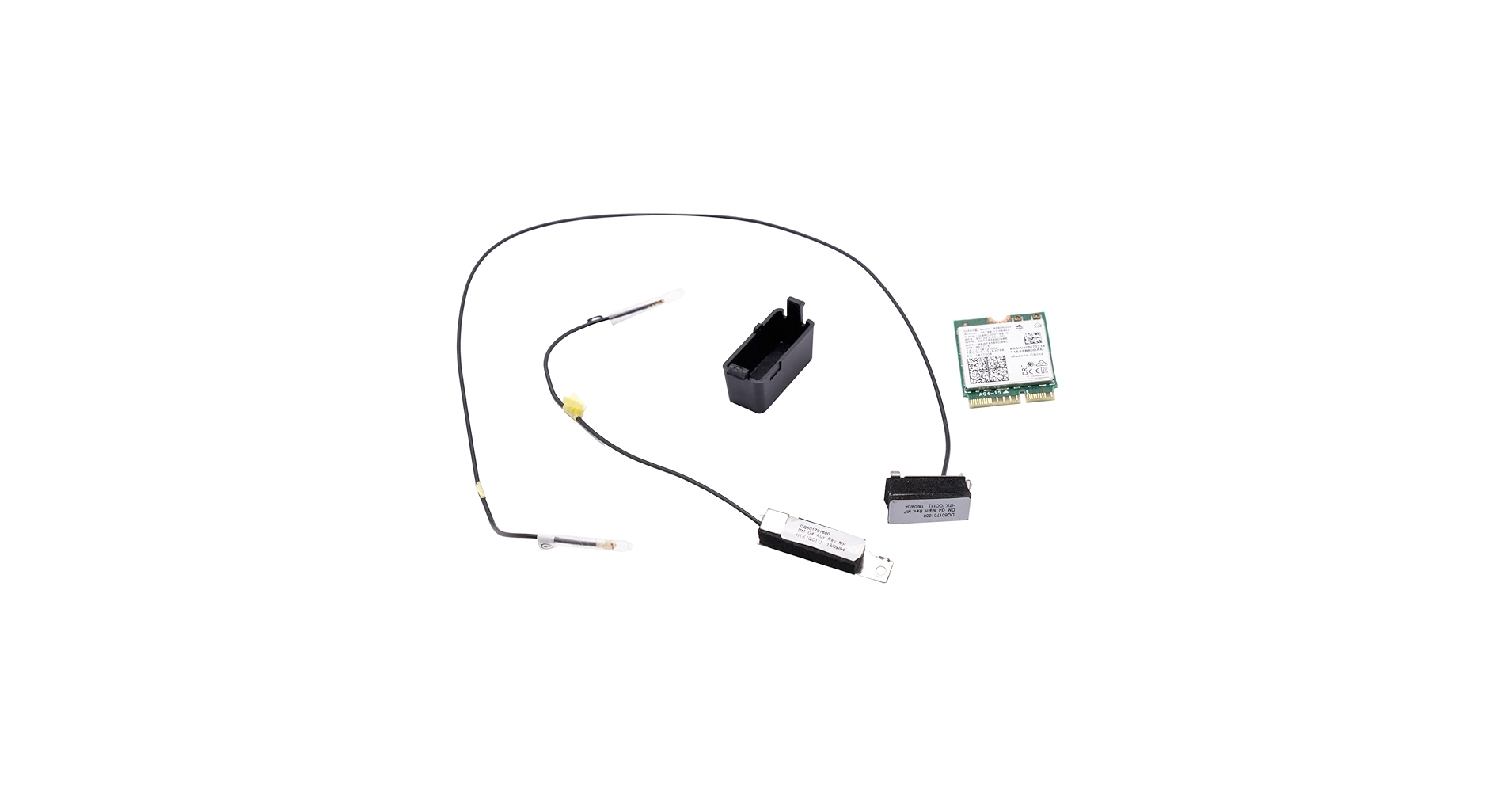

your chassis may not have come with the necessary wiring to connect the wifi card to the needed wifi antennas
for this reason i recommend the HP kits that have the cable/card, which route the antennas/cables internally
if you want to use a intel AX210e card you need to buy the cables/card separately
https://www.amazon.com/BestParts-Replacement-EliteDesk-DQ601701600-937263-001/dp/B0BD7MX5CB
https://www.amazon.com/Wi-Fi-AX210-802-11ax-Bluetooth-AX210NGW/dp/B08P2RVWSL
HP exploded parts diagram
https://support.hp.com/us-en/document/c06516579
if using a aftermarket kit you need to make sure the included wiring antenna cables are long enough to connect the card/antennas also you need to find a place to make the mounting holes for the external antenna jacks
https://www.amazon.com/999M85-WiFi6E-Antenna-Extension-15-3cm/dp/B09QKYT7TT
