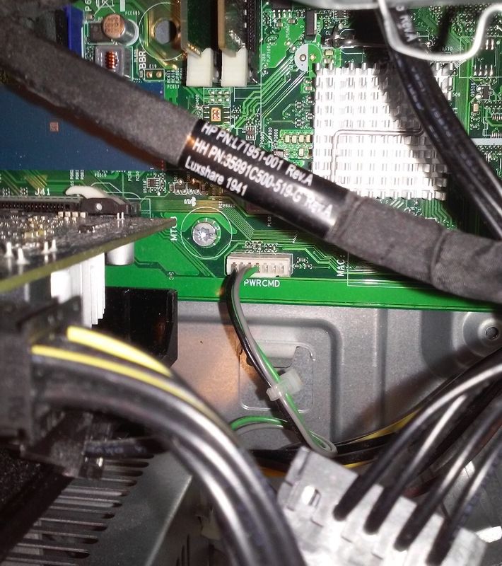

The only physical difference I can see between the two power supplies, other than the voltage rating, is that the cable that goes into the 'PWRCMD' plug on the motherboard has three wires on the 310W power supply, but has SIX wires on the 400W power supply. I do not know what those additional three wires do/control.

The PWRCMD cable on the 310W power supply :
The PWRCMD cable on the 400W power supply :
