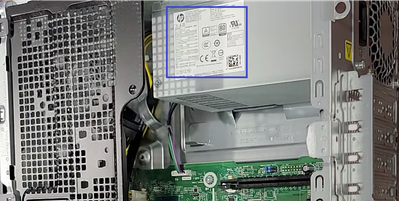

Thank you so much for your reply.  I've verified that the motherboard is 8767.  I haven't updated the power supply, so it's whatever it came with - but I'm unsure how to verify that it's a 310-watt.  Can you tell me where I would find that information?
@Ekir75,
Just open the PC's side panel and look at the power supply's label. You'll see both its part number and total wattage.
Kind Regards,
NonSequitur777
@Ekir75,
And this is how you remove the side panel:
1.) Safety first: unplug your PC from power, and push in your PC's power button for four seconds in order to release any residual power.
2.) unscrew this screw found at the back of your PC either with a flathead or star screwdriver:
3.) Then slide the top panel back and set it aside.  You will see the power supply's label here:
Kind Regards,
NonSequitur777
Thank you!  I can confirm it is 180W, part #L70042-001.
