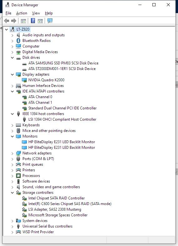

As listed in Device Manager
(This is the Boot HDD)
ATA Samsung SSD PM83 SCSI Disk Device (It is a SATA6.0Gbps drive)
(Backup HDD)
ATA ST20000DM001-1ER1 SCSI Disk Device (2TB Seagate 7200RPM)
(DVD-Writer)
HP Model SH-216 (from looking at the physical drive)

All four connectors of "15 - SCU 3Gb/s" are occupied. Pretty sure this is why the drives show up as SCSI.
As I was looking through things in Device Manager, I realized that I don't think the DVD-Writer has ever worked. It's obviously not a big problem since I don't even have any disks to use for it, but it should be hooked up correctly IMO. It has power, as it will open and close, but that's it.
I don't know why the hard drives are connected to the number 15 connectors. I can't see any reason why a SATA drive wouldn't be on a SATA connector. (Can I use the same cables?)

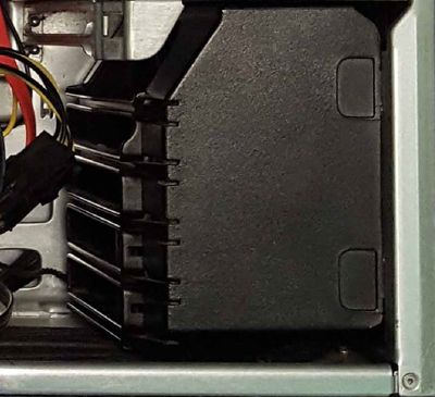

I took pictures inside my PC when I had it open and I see the cables you mention. I thought they were cables for the HDD bay.
You can also see the HDD cables here.
I'll change the hard drives tomorrow (Saturday) and hopefully, it'll all go well 😄

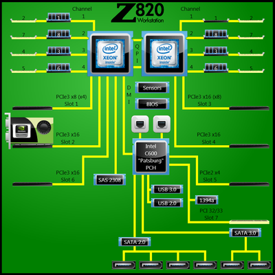

Interesting that the DVD drive is visible in the BIOS (as HP CDDVDW SH-216BB), but not visible in the HP Performance Advisor Block Diagram.
The same goes for the two hard drives BTW. They show up in the Mini OROM Display but nothing in the Block Diagram in the HP Perf Adv.
(and yes I do have a "missing" RAM chip... I have tried to take it out and re-seat it, but it doesn't take long (a couple of days) before it disappears again - is it a connection issue or a chip issue?)
1ER1 is the 2GB rotary HDD, The PM83 is the C: drive SSD, and the USB device is the :-O USB drive.1ER1 is the 2GB rotary HDD, The PM83 is the C: drive SSD, and the USB device is the 😮 USB drive.
No DVD drive. How come these drives do not show up in the Block Diagram?
The H: drive is an external USB driveThe H: drive is an external USB drive
This doesn't list my C: drive. Only the USB drive (as disk1!) and the rotary Backup HDD.

Your issue with Performance Advisor is a bit strange. I took a screen shot of my block diagram and it appears to show all my drives except for a 1TB drive plugged into one of the SCU ports (indicated as SATA 2.0 in the block diagram).
I have a 480GB SSD and 2TB HDD drives plugged into the SATA 3.0 ports, the DVD drive and a 4TB HDD drive (in 3 partitions) in the adjacent SATA 2.0 ports, a 2TB HDD and 1TB HDD (not shown in the diagram?) in the SCU ports, and finally a 256GB SM951 M.2 card on one of the PCIe slots (shown as a Z Turbo drive).  I don't have any issues with any of the drives, all are visible in Windows Explorer. If you do wish to compare disk performance then I would suggest you try CrystalDIskMark (free) to measure the read/write speeds of your drives.
Have you checked all the Security settings in your BIOS to make sure the DVD  drive access is not restricted? There are numerous settings in the HP BIOS to enable or disable various components on the HP motherboard, such as USB ports, SATA ports, PCIe slots, etc.
If you're still at a loss regarding the DVD drive then I would recommend you start a new thread on the forum since this thread is now flagged as being solved.
P.S. Try clicking on the SATA 2.0 and SATA 3.0 icons on your block diagram to see if it detects and lists your physical drives? Mine does but doesn't show all the drives in the block diagram?, i.e. there's one missing.
