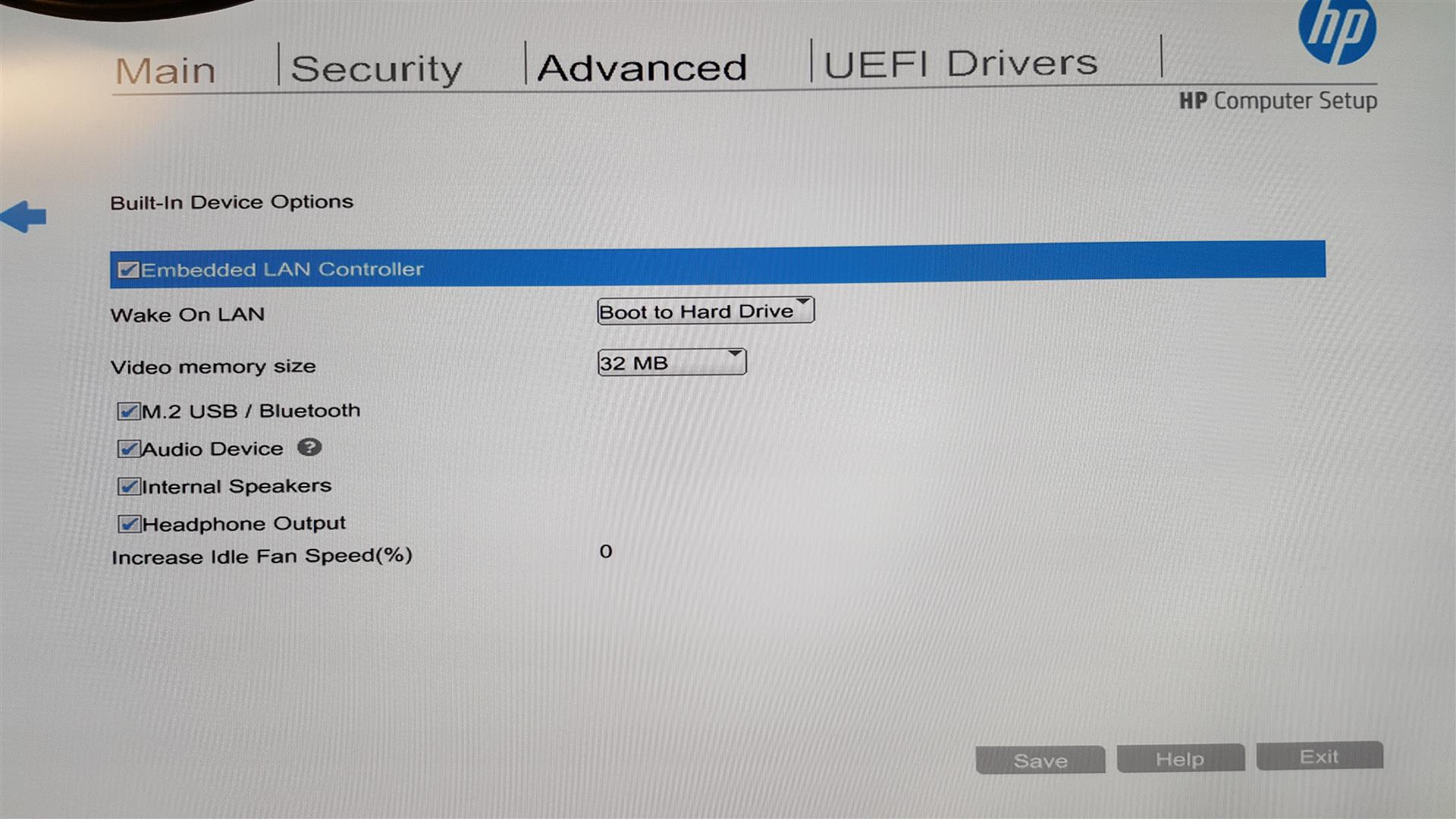

Thanks for responding Grzwacs ... I have updated the BIOS to the lates and prior it showed the option in Storage for M.2 as shown in the pictures below.  I piurchased what I believe to be a compatible M.2 as it specifies it can handle a 256GB Sata or PCIe M.2.  I purchased a Sandisk SSD X400 M.2 2280 SATA III but I have also tried a Micron 512GB PCIe NVME M.2 2280 and they just dont show up in the BIOS Boot order or otherwise, and also not in hte OS. Right now its boot from the pre-configured 500GB 7200rpm HDD ... and i have updated Bios, IME and Rapid Storage drivers.  I have also seen the disclaimer about the M.2 configurations had to be configured at purchase .. but what other product doesnt say that and its esay to upgrade later.  Unless theres some magic switch I havent found I dont see how I can upgrade to the M.2 SSD.  Anybody  get past this hurdle.
20170516_062254 (Large).jpg20170516_062332 (Large).jpg20170516_062343 (Large).jpg20170516_062356 (Large).jpg20170516_062318 (Large).jpg
