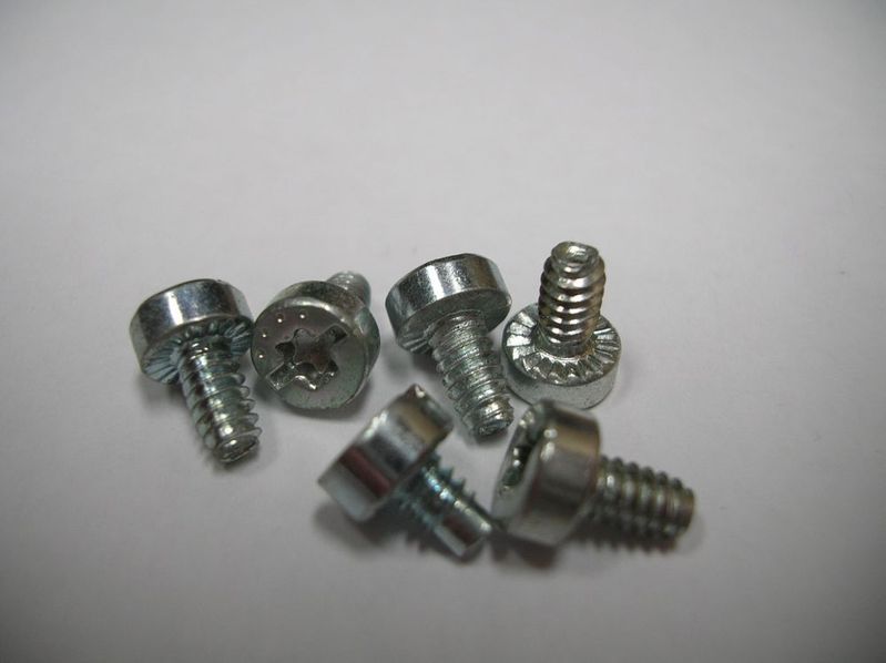

Sorry Savism, I forgot to reply.
Attached are instructions from a similar PC + some screw pix.
You attach 4 screws to the hard disk  (HD), slide HD into cage and the (black) latch on the outside of the cage secures the HD by latching one of the 4 screws.
Note: I dont know the exact screw type -  it's either the HP 'blue' type, M3 (metric) or 6-32 screw (see pix).

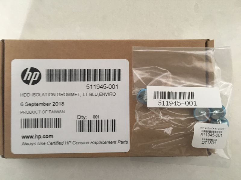

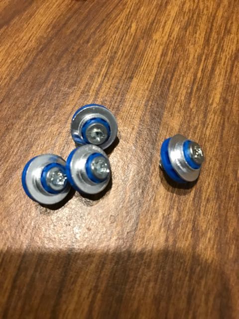

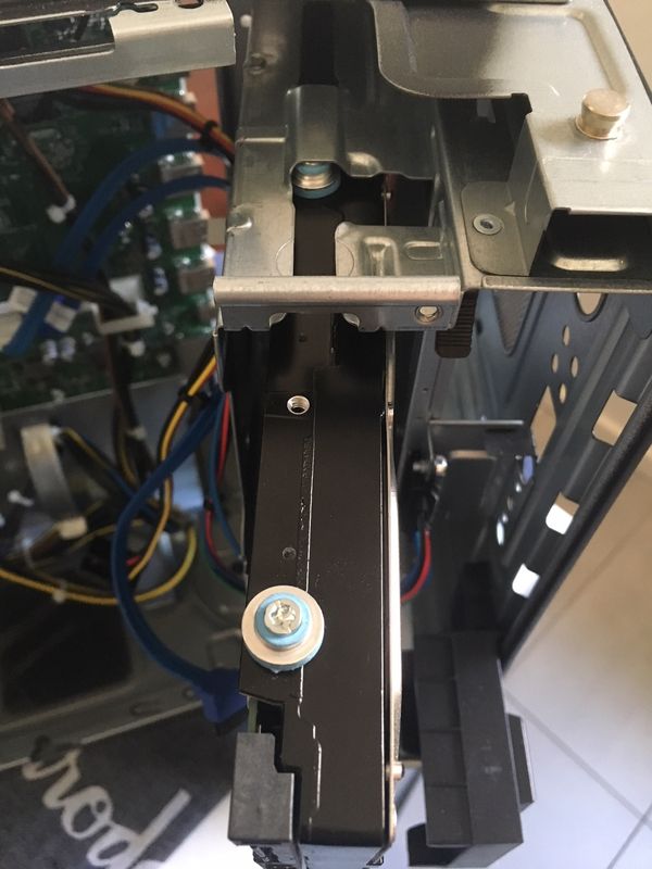

I was finally able to install the second disk. Part (screws) arrived on Friday – 6-32 blue isolation screws. HP part number is 511945-001 "Hard drive isolation grommets (Blue color)."
Caddy/adapter is NOT needed.
The older configuration provided spare screws behind the front bezel. This computer does not have it, so you have to order them.
I have also found these part numbers: 594220-001 & 450712-001. They appear to be the same.
If you cannot order them from the HP, their reseller (800-797-7164) sells them for $14 plus shipping from FL. I have also found them on Amazon and E-Bay -
If you cannot order them from the HP, their reseller (800-797-7164) sells them for $14 plus shipping from FL. I have also found them on Amazon and E-Bay - https://www.ebay.com/p/HP-450712-001-Hard-Drive-Isolation-Grommet-Mounting-Screws-for-DC5800-DC7900/...
See attached photos.
