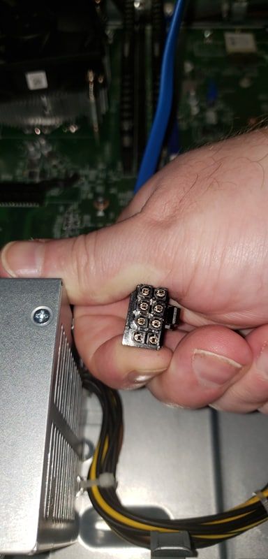

I opened the case again and changed the RAM. I noticed a little 2 pin connector attached to the 6 pin connector and it combines to make an 8 pin. I'm guessing I can run a different card with the 8 pin combo but would it actually be powerful enough? I only have 1 SSD connected buy 2 installed and no spinning drive attached. Think I could possibly get by with a Radeon RX 580 or something similar? 🙂53423658_326575524660430_4737139053911080960_n.jpg54230678_381972889049768_2293350156235440128_n.jpg
@XFastZ28X, you are correct that it is an 8-pin PCIe connector.  Whichever, video card that you decide to buy, it has to run with the 400W PSU.  I looked at one RX 580 and it required a 500W PSU.
