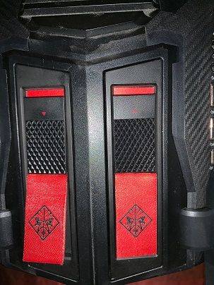

Where can one purchase or obtain the external Hot swop HDD Cady from for a HP Omen 880-P0xx Desktop PC?
I was at the understanding that the "covers" themselves came with both left and right sides for the one part number.
I just asked the HP Store chat service to confirm it for clarity. They say it does.

The internal HDD bays the mount from the top doors should already be mounted with that case.
If you need another, its  part number 928160-001 Internal HDD Placeholder.
and 928174-001 Cover - Top, External HDD
You would also need a sata cable to connect the mother board with.
http://partsurfer.hp.com/Search.aspx?searchText=928160-001
http://partsurfer.hp.com/Search.aspx?searchText=928174-001
So from the picture at the start, what you are saying is the metal case is one part & the pre shaped top plastic bit with the red ribon & locking latch is the other?
Caddy CaseCaddy Case928160-001 Internal HDD Placeholder
Caddy Top & LatchCaddy Top & Latch928174-001 Cover - Top, External HDD
Is that correct?
However there are two "Handed" slots in the top, therefore there should be two top parts listedTwin Case small.jpg
