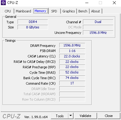

My best guess for memory is to use download and run CPU-z and make a note of the memory SPD and manufacturer and obtain the same the of chips but 8gb or even 16gb but make sure that you are allowed to return them if not compatible.  Rank dual means "R2" when looking up DDR4 memory. For example:
RAM TypesRAM Types
I just had a look at it, I hope you don't mind if I ask a bit more - it seems my RAM are "single" and not DUAL
Though it does show DUAL under memory fan
I'm wondering if that means there is no Dual Option for me. I know my MB only has 2 slots, and I had a look at some RAM
that has following specs, a bit higher MHz, should follow much of what I got of info from HP Support assistant
