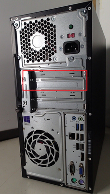

What I would try first is the following: as your GTX 660 Ti is a 2-slot graphics card, remove the two remaining PCIe brackets (shown within the red square) -if you haven't removed them already, to improve airflow inside your desktop next to your graphics card:
