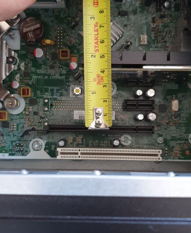

The BIG problem I have is the size of a GPU that I can fit in this Micro tower. Now I know why its called MICRO. You can see on the pictures that I can fit there only something small in todays standards. Something with only 1 fan. And it should be shorter than 17cm. I would say that maybe even shorter than 16cm since one bolt of the CPU heat sink is in the way. Since its taller than the black PCIE x16 graphic card slot by 1 or 2 mm. Meaning that it will block the card from connecting to the slot properly. Even if not it will lay on it/touch it for sure and I dont even know if it can do that.
The second problem is the thickens. As you can see it can be only 4 cm thick. The AC1300 dual band wi-fi is in there.

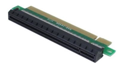

You would have to do some research as to dimensions which brand/model of the aforementioned graphics cards would fit in your MT chassis. I have one trick for you though, in one of my projects I ran in the GPU's length-dimensional issue as well.  I was able to resolve this by using a PCIe x16 extension riser adapter card, because I had room "up" to work with within the tower case:
Like this example: https://www.amazon.com/GODSHARK-PCI-Express-Extension-Protector-Adapter/dp/B07RWRK2L6/ref=sr_1_74?cr....

Thanks for the idea with PCIe x16 extension. I will research it.

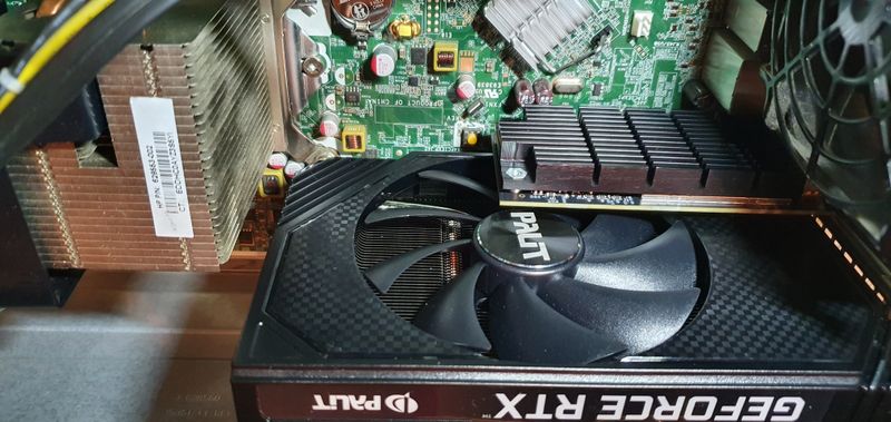

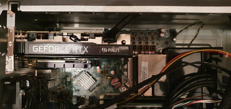

Hi. Thank you everyone , especially to NonSequitur777. I had fun doing this.
I bought the Palit RTX 3060 12GB storm X.  Took me some time to fit it in (My first time.) together with be quiet PSU 750W. PSU only on 2 screws but it holds.
NonSequitur777  the ASUS Phoenix Nvidia GeForce RTX 3060 12GB(177 mm x 128 mm x 51 mm)   is a little bit bigger than Palit  RTX3060 12GB storm X 170mm x125mmx39mm. The Asus wont fit in next to my wifi and is 7mm longer/closer to the CPU heat sink.

@Michal212,
Outstanding, this looks great!
Keep the existing heatsink, works just fine with an i7-3770K.
It's about airflow, and since your MT has both a front (CPU) and rear chassis cooling fan inline, I would doubt you'll have to upgrade cooling fans.
