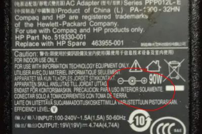

Hi have an HP 800 G3 DM with a 65W power adapter but I wanted to upgrade to a 65W cpu and need to upgrade to a 90+ watts adapter.
My question is that I find a lot of HP adapters with 90W and even higher but I'm not sure if they work with this as the drawing in the back doesn't show the sensor pin indication.
This is what I have
This is the symbol on my adapterThis is the symbol on my adapter
This is what I found online

This parts list for a random 800 G3 65W DM product number I picked from a list has the 90W power supply part # you need:
HP PartSurfer
917251-001
GNRC power supply unit 90W DM PWR ADPTR
I'd do a search by the above part number to make sure you get the right one.
Thanks, but where I'm is not easy to get specific parts, I can buy some second hand HP adapters with the voltage and plug that is equal to the one I have but if only the ones that are listed in the partsurfer are supported I'm screwed!
You're very welcome.
There would be no way I can tell you with a 100% guarantee that what you want to buy will work.
HP doesn't sell that part because I checked the HP online parts store for Portugal.
The power supply you found should work if it has the same specs, but you never know.
The only way to find out is to try it and see.
The PC will give a 3.4 beep/blink code if the power supply is not supported.
There's plenty of the 800 G3 DM part numbers for sale on the eBay.US website but you would have to pay a fortune to have it mailed to Portugal.
