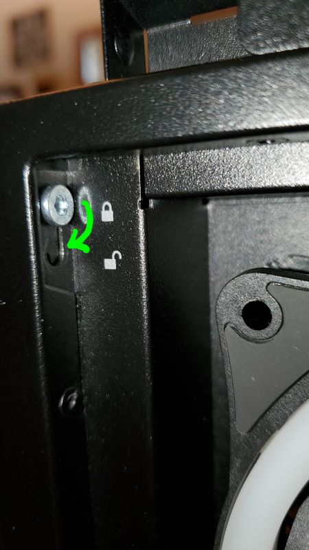

The left side glass panel needs to be easily unlocked from under the front glass fan panel and a Torx T-15 bit to drop the screw. The right metal panel might already be dropped (unlocked).

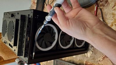

Once the front glass fan cover is removed, remove the grid panel that covers the fans and look at the top left and right corners on the chassis. You'll see the two screws (locked is up, unlocked is down). Using the Torx T-15 bit, loosen the left-side screw for the glass panel (a flexible screwdriver works the best) and it will drop. Follow the same procedure for the right side if it isn't already unlocked. Lastly, tighten the screw(s) in-place.
The left glass panel door will now release when pressing the button on the top of the chassis.After removing the fan's glass panel and grid coverAfter removing the fan's glass panel and grid coverThe lock/unlock screws are in the top left & right corners of the chassisThe lock/unlock screws are in the top left & right corners of the chassis20240518_134909.jpgA flexible screwdriver extension works the bestA flexible screwdriver extension works the bestTorx T-15 bitTorx T-15 bit

As you may have noticed, I already found my own solution for unlocking my new OMEN 40L three days before you posted your reply.
After giving up looking for instructions on the HP Community, I found the locking/unlocking screws myself when I opened the front fan cover panels. I posted photos and instructions on May 18, 2024 to hopefully help others to easily unlock their cases more quickly.

Here are my instructions:
‎05-18-2024 02:55 PM- edited‎05-20-2024 11:19 AM
Product: OMEN by HP 40L Gaming Desktop PC GT21-1000i RCTO
The left side glass panel needs to be easily unlocked from under the front glass fan panel using a Torx T-15 bit to drop the screw. The right metal panel screw might already be dropped (unlocked).
Once the front glass fan cover is removed, remove the grid panel that covers the fans and look at the top left and right corners on the chassis. You'll see the two screws (locked is up, unlocked is down). Using the Torx T-15 bit, loosen the left-side screw for the left glass panel (a flexible screwdriver works the best) and it will drop. Follow the same procedure for the right side if it isn't already unlocked. Lastly, tighten the screw(s) in-place.
The Left side glass panel door will now release when pressing down on the button on top of the chassis above the left  side panel. The Right side panel has the same button above it at the top of the chassis.
View after removing the front glass panel and grid cover:
After removing the FRONT glass panel and grid cover in front of the fans, you'll see the screws on the top left & right corners. Loosen the screw so it drops to the UNLOCKED position, then tighten the screw.
Remember: the lock/unlock screws are in the FRONT top left & right corners of the chassis behind both the front glass panel and the removeable grid in front of the fans:
The tools I used:
