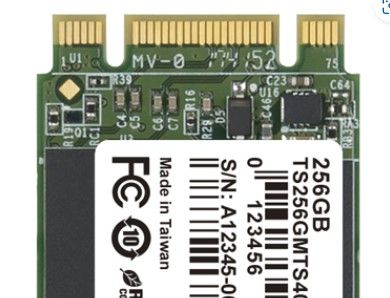

Ahhhhh i see, thank since I did not see the other notch in there on the board itself I thought this would work thank you for the info
From what I'm seeing it looks like anything above 256 is only a single notch
You´re welcome, but I tell you this 'so you understand, but the reason is that it has no processor or chipset that can support M.2 NVME disks even if they both use the same slot, with the SATa-3 there is a pin in the air but the same M.2 slot is used.
