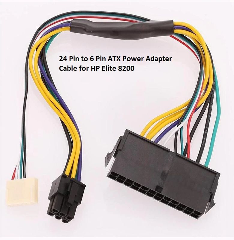

Hi Itsmyname,
With your indulgence, you are quite right that HP doesn't provide a PSU upgrade for this SFF.
However, that hasn't stopped some very imaginative out-of-the-box thinking folks to come up with viable and safe power solutions.
Just as with my HP Pro 6300 SFF, there are desktop-specific ATX power adapters available to get around the proprietary HP PSU configurations.  See, for example my rig: Solved: Upgrading HP Compaq Pro 6300 SFF - Page 5 - HP Support Community - 8184303
@Kai24 , just search for "ATX 24 pin to 6 pin Adapter Cable for HP Elite 8200" in Amazon, AliExpress, eBay, etc. and you'll be greeted with numerous seller options.
[EDIT:] -The power adapter cable for your rig, as chance would have it, is actually the same for my HP 6300 Pro SFF:
Good luck!
[EDIT:] DISCLAIMER: Lest I forget, I should point out that HP does NOT endorse these non-HP engineered parts and applications.  Installing these non-HP parts would invalidate your PC warranty, and you will assume any risk(s) and/or damages associated with or resulting from utilizing these non-HP endorsed modifications if you were to choose to install them in your PC.
