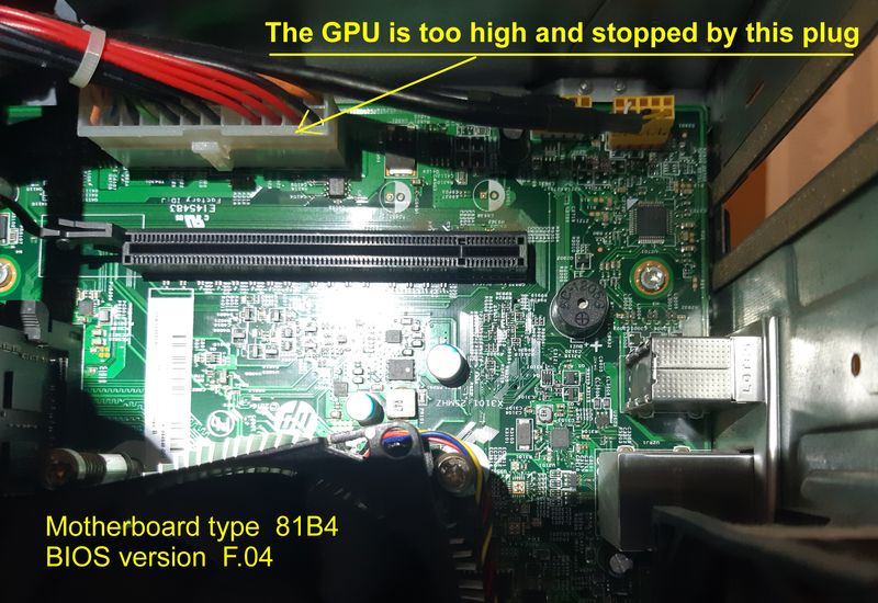

My attempt to install my spare  Nividia GT 730 card was unsuccessful, although it may have worked if I could physically fit the GPU on the mother board.
Seems to be many types and sizes of the GT 730 cards, however my card has a  large heat sink instead of a fan ( Model name GV-N730SL-2GL ) Your idea was good, but wouldn't fit.
I'm still currently plugged into the motherboards integrated video port and works fine, but would still like to fit a better GPU to support my Photo/Movie editing software,..do you have other suggestions.
Kind Thanks, Kevin

NOTE:  for your information see images attached of the AMB R5 330 (OEM) v NVIDIA GT 730 that wouldn'tAMD R5 330 v NVIDIA GT 730.jpgMB power cable issue.jpg fit
You're very welcome.
Yes, I can see the huge difference in the width.
So, it appears you may have to use a graphics card with a fan.
The question is...how much you want to spend.
This would be the best card you can install for the power supply your PC has but, in my opinion, it is rather expensive ($99 USD) new.
You can see that it is not very wide and should have no problem fitting.
