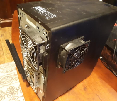

1.) First of all, improve the airflow through your desktop and especially through your CPU heatsink. You can do this by adding one or more chassis cooling fans and by upgrading your CPU heatsink -I'll post some pictures of how I have done that in various desktops. Trust me, there is always a place or places to add an 80 or 90mm cooling fan [BE CREATIVE - think outside the box! (pun intended)], even in an Envy, such as here (externally):
Yes, in addition to a fitting diameter cooling fan (90x90mm?) + finger guard/grille, it will require cutting/drilling a small access point (just 7mm x 11mm) for the 4-pin PWM cooling fan connector, and a 4-pin PWM cooling fan splitter cable, but once installed blowing air IN, instead of having just a passive air-intake, you just substantially improved the airflow through your case.

03-13-2024 08:01 PM - edited 03-14-2024 09:01 PM
Here are just three examples of close to a dozen modified legacy HP desktops I have upgraded the last 2+ years:
Cooling Solution exhibit #1: In addition to upgrading the CPU heatsink/cooling fan combo in my HP Z2 Tower G4 Workstation, you can see three of the added four 90x90mm blue LED cooling fans (two behind the front panel and one internally placed in the side panel above the CPU) all blowing air in:
Cooling Solution exhibit #2:
Sorry for the dust: here is my mothballed HP ProDesk 600 G4 MT (Mini Tower) with two externally positioned high-performance cooling fans also both blowing air in (exhausting air out through the front):
Cooling Solution exhibit #3:
A souped-up HP EliteDesk G1 TWR (Tower) with one internally fitted 90x90mm cooling fan on the side panel blowing air in also directly over the CPU heatsink in order to adequately cool the famed "Devil's Canyon" processor (i7-4790K) :
