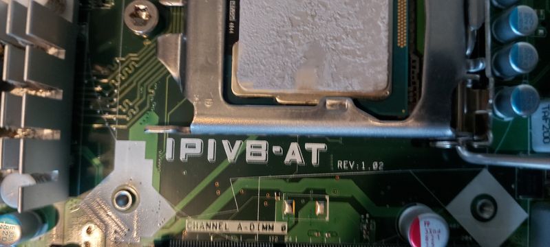

HI all, the power button snapped off the motherboard of my all in one desktop and its a good PC and wanted to replace the motherboard, I did try a repair myself as I have an electronics background but no joy.  Does anyone know the exact model or part number for the motherbaord I need to replace it with?  I have attached pictures20200606_173251.jpg20200606_174401.jpg20200606_174550.jpg20200606_174555.jpg20200606_174651.jpg20200606_174744.jpg
model 23f412ea  product  number G5Q25EA#ABU
@dazorama
721377-501 HP System Board (Motherboard)

The part number is listed at HP partsurfer.  You might not like the answer:
https://www.memory4less.com/hp-computer-system-board-721377-501          cheapest so far
https://www.impactcomputers.com/721377-501.html
https://harddiskdirect.com/721377-501-hp-desktop-motherboard.html
What did the local shop say?

Thank you WB2001!   Very kind of you to look up some prices for me also!  I am in the UK and the only motherboard I could find was £160 from china.  I looked up the part number on HP Parts using the model and serial number and it showed an old motherboard nothing like the one I need, could you possibly reply with the part number so I can continue to keep an eye out for a working used one.  The shop said it would cost a lot of money to replace the motherboard and it clearly will.  The circuit track was damaged when  the power button snapped off so there in nowhere I could solder it back on the correct side so tried the opposing side with a makeshift fix which didn't work.   To be honest I think HP should fix it as its a design flaw!  this PC has been well looked after by adults only so only normal pressure was applied to the power button when turning on or off yet it snapped anyways,  shame it doesn't have a separate power board that I could just replace.
@dazorama
