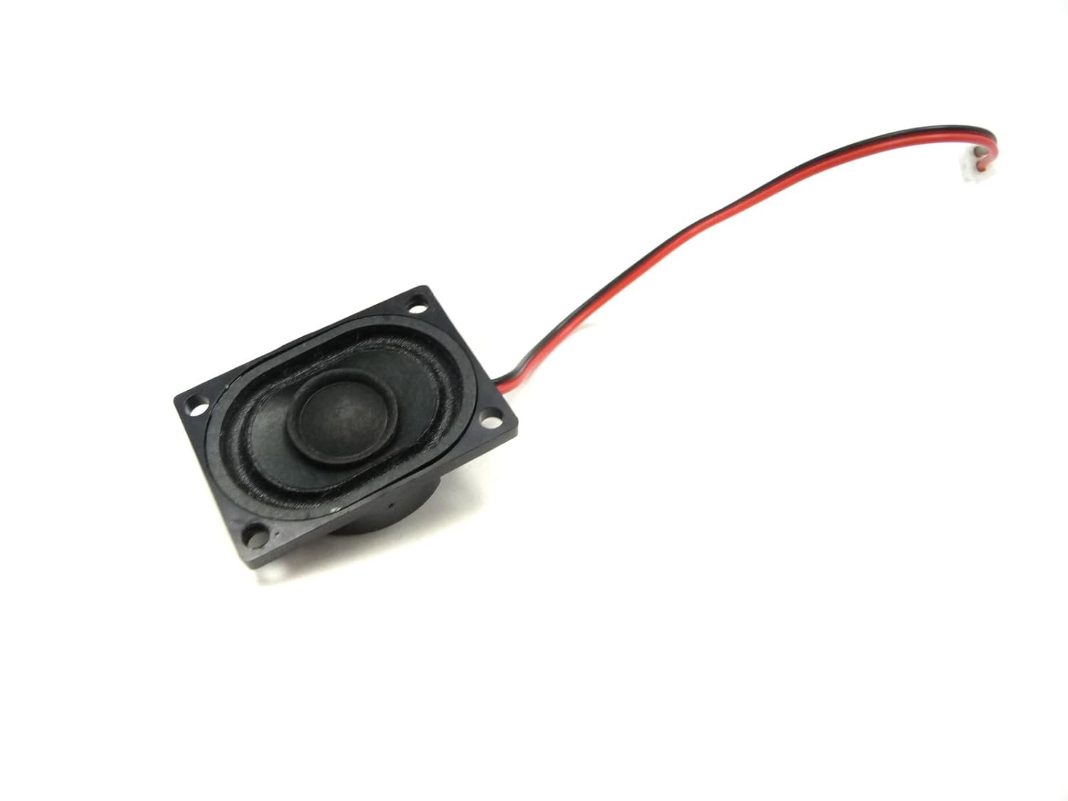

I bought recently a motherboard used in some HP desktops in the past, the Asus IPIBL-LB, but I found that it hasn't the classic 4 pins connector for the system speaker. instead of it I found just a two pins connector, similar to those used for fans.
How can I connect my system speaker to that connector?
Thanks much in advance for support.

You won't be able to as far as I know.
HP uses speakers that connect with two wires such as this one...
HP Speaker Assembly 40x28,5mm, HP Part # 394779-001

Yep Paul,
you gave me the answer indeed.
I'm looking for it on some online stores, but I found some various models in addition to taht you mentioned,  such as: 647447-001 or 447085-001. Are they all equal for me?

Yes, either of those part numbers you posted would also be fine.
