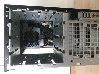

I am trying to install a total of 6 HDDs into my Z420 in an attempt to turn it into a FreeNAS server. I´ve tried several carriers / converters for the 5,25 " slots, but the same problem persists. The screw holes do not line up between the case and the carrier.
I´ve tried an IcyDock that they said should be compatible with the Z420, but no go.
The latest attempt was bying the 3,5 - 5,25 " carrier directly from HP (part no 683870-001), but even that has the very same problem.
Here´s a picture of the side of the Z420
and here is one from the front.
It seems something is missing, but I have not been able to solve this. Does anyone have any experience with this, and can point me in the right diretion?
Much apprecieated...
Ok, I figured it out.
My problem was that whatever I slide into the 5,25 bay, it doesn´t attach to anything, and i couldn´t get screw holes to line up. But the solution was really simple. I simply attached screws to the 3,5 - 5,25 converter, and they hooked onto a rail as I inserted them, All the way in they even clicked into place.
Having solved the issue, I´m sticking with my HP converters, even though they were crazy expensive in my opinion. But any generic device, like the on you suggested, Wb2001, should work the same way.
Thanks for helping me.
