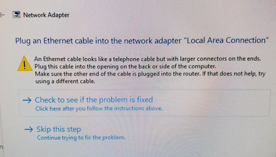

Internet Adapter is not being recognized. Tested the Cat5e cable and everything works fine on two other laptops.

That is a desktop that HP no longer provides  drivers or support for.
You did not mention the installed OS or whether or not you are referring to the motherboard NIC or an installed  PCIe network adapter.
Use a USB wifi dongle that has support for the OS you have installed or install a network adapter card that also has support for the OS.
I have no idea what generation your desktop is from. It may be that only CAT4 will work with it.

What is the installed operating system?
My 2.0 USB to RJ45 Adaptor came in today. I installed the Adaptor and reset all the network drivers and I'm back on the internet. Everything works outstanding for this old 20 plus year old computer.
