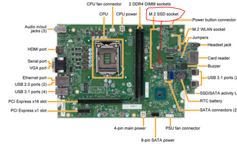

Your PC's  motherboard has two SATA connections and one M.2 2280 PCIe socket. This is the motherboard's limit with respect to storage options.
The two SATA connections are occupied by an optical drive and a 1 TB HDD.
You should have an open M.2 socket which can be used to install a M.2 NVME PCIe 3.0x4 SSD.

Hi,
See image below.
The 2280 M.2 socket should be open.
Regards

The image in my previous post is your motherboard.
