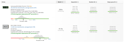

In addition, looking at actual HP ProDesk 400 G6 DM Users, such as: HP ProDesk 400 G6 Desktop Mini PC Performance Results - UserBenchmark and: HP ProDesk 400 G6 Desktop Mini PC Performance Results - UserBenchmark, you can see both an M.2 NVMe SSD and an HDD/SSD.

Lest I forgot to mention it, I do have experience with HP "DM" models, such as my HP EliteDesk 800 G4 DM upgrade project: Solved: Upgrading an HP EliteDesk 800 65W G4 Desktop Mini (DM) - HP Support Community - 8708671, where I installed both an M.2 NVMe SSD and an SSD: HP EliteDesk 800 G4 DM 65W (TAA) Performance Results - UserBenchmark:
