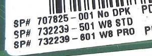

I am guessing you have this model, please verify
The 732239-601 is used in the HP PAVILION CTO 500-210QE
The latest bios is 80.21 dated Oct 2, 2015
Power your motherboard up using the build in graphics and verify your BIOS SSID is 2AF7
If you have 2AF7 and an older bios then try the new one
https://support.hp.com/us-en/drivers/selfservice/swdetails/hp-pavilion-500-200-desktop-pc-series/539...

Just checked, I have the 732240 - 601 model.
