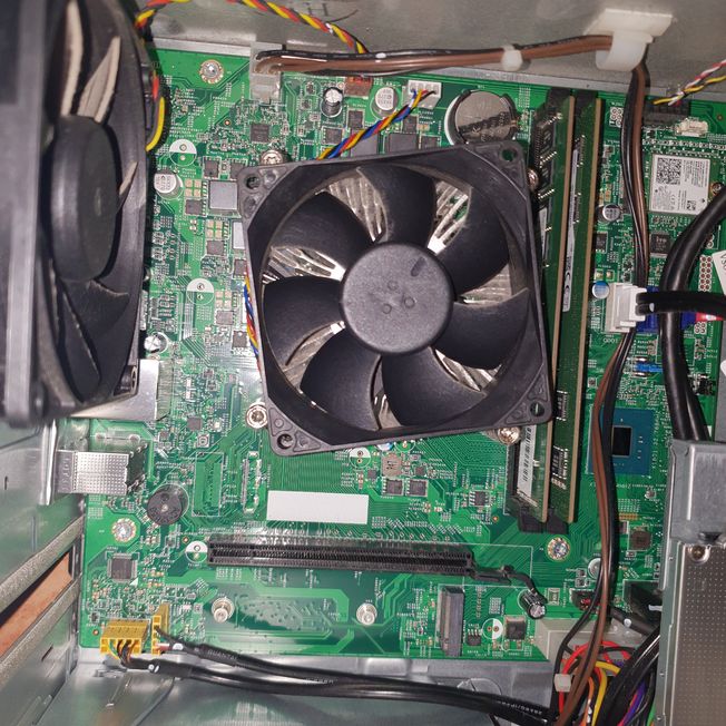

 This is the motherboard
Capacity should not be an issue.  Your motherboard should support any size m.2 SSD that is currently on the market as long as it physically fits in your system.
