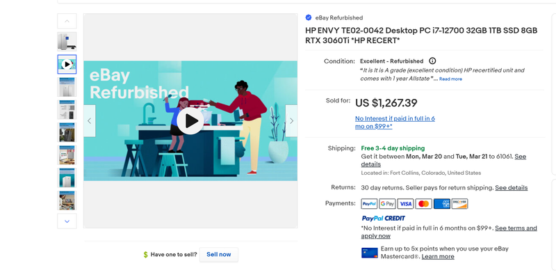

Colocomputer is an E-Bay market seller (insert joke here) who claimed in their ad that the unit was "HP Recertified" and represented in our discussion thread that Colocomputer is an authorized HP reseller.  I am going to bring this up with E-Bay and try to initiate a return. They did offer to swamp it with what they describe as "a unit with the exact same motherboard" but I cannot see the point of that exercise.  I am also wondering if a crime was committed here, but I do not expect the HP IT wizards on this board to be able to answer that.

I have here, a model from the same seller
see above
https://www.ebay.com/itm/225442974555#readMoreDesc
HP ENVY TE02-0042
but then it gives in reference
about this item
319L0AAR#ABA
ENVY TE02-0042
except that this reference often corresponds to another model
https://www.google.com/search?q=319L0AAR%23ABA
but that's not all then at the bottom
SPECIFICATIONS
HP ENVY TE02-0042
Product Number 8MP65AV
more the same
and also
https://www.google.com/search?q=%098MP65AV
but the models will not look like yours
may be a simple confusion in the product numbers
you should also check the serial number here:
https://support.hp.com/us-en
maybe there could be several reference, configuration, but here
https://support.hp.com/us-en/document/c08326025
319Q4AA#ABA
and found on amazon
https://www.amazon.com/dp/B0B75K5K18?tag=camelproducts-20&linkCode=ogi&th=1&psc=1&language=en_US
see the references of your purchase page, and what is in the computer

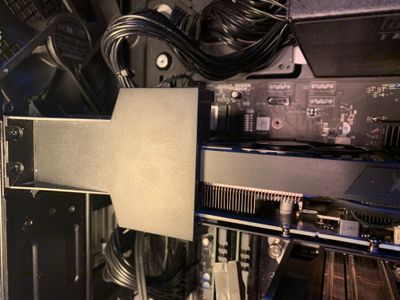

Promethee, your research skills are formidable. I may have to have you lecture several classes with my students. I found an online review of this model, and in the review, the reviewer said that he could only find two total ports, one for WLAN and one for NVMe. However, several of the responses to the video noted that the M2 SATA port is, as you originally thought, hidden underneath the GPU. I am in the process of trying to remove the GPU bracket as described in HP is helpful video. However, having removed the two retaining screws, find the bracket cemented in place by some other source, because it does not even shift with the retaining screws removed. Am I missing something?
 also, the graphics card power interface does not seem to be as described in the video. I’m not sure from where it is sourcing its power.
