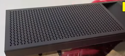

Unfortunately I don't see any fan mounting holes in the top of the case.  See if you can mount a fan underneath using cable ties or a pair of thin screws that with  washers that fit through the air holes.  If you put the fan or fans on top be sure to use a fan grill

I would do the following before drilling through glass

According to the HP parts store it is glass or that is the name of the replacement part: "left side glass".  See this thread
https://h30434.www3.hp.com/t5/Desktop-Hardware-and-Upgrade-Questions/Glaspanel-for-HP-OMEN/m-p/83746...
For warrantee the OEM wants the part returned like it was when bought.  If you have eVga GTX-1070 with two fans and replaced the two fans with the eVga Hybrid kit, then you need to put the two fan cooler back on.  However an entire computer is different.  Depending on what went wrong they may actually repair the system.  Cost wise it is normally cheaper to replace it immediately and then sell the used one as refurbished using a 3rd party.  In this case they do NOT want a hole in the case even if there is a really custom fan grill covering the hole that make it look like a killer gaming case.
The case I looked at (above) had an ordinary case fan in the back.  You might consider getting a Corsair closed liquid cooling system.  They make one with a single radiator that fits where the rear fan is.  You will have to research the wattage to ensure it can dissipate the CPUs heat.  A big benefit is the fan noise.
You may find that setting the %CPU MAX down to 95 may be all that is needed.  That worked for me on a dual Xeon that ran hot even with liquid cooling.  Some HP systems do not allow hyperthreading to be disabled but it is worth checking.  If your computer game uses "6 cores" it may actually be using only 3 cores with the other 3 being threads in the same cores.  Disabling hyperthreading spread the game threads out over all the cores with less likelihood of overheating a core.
