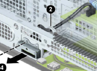

Looking that the manual that shows an illustrated assembly it appears that SD reader is part of the motherboard
The part with ID "5" is the reader but that is shown as part of the motherboard just under the single USBC, which is under the  two pair of USB3
The Z1 G5 tower appears to have the exact same front case as your Z1 G8.  However the motherboard is different and there is no SD reader under the USBC which is under the two pair of USB3
That part that goes to all the "Z1" EXCEPT THE G8 is listed here
a picture of the card reader is here
note this is the G5
Please look at your motherboard and see if something like the above will fit and there is a USB3 socket for the adapter to plug into.
I am pretty sure that this is the part
But it may not fit on your G8
[edit] As @DGroves wrote your best best is to get a dongle or adapter that plugs into an existing USB3 port.
