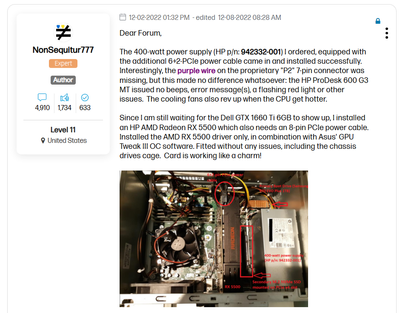

You should be fine.
Your issue reminded me of a similar power supply upgrade 7-pin "P2" power connector difference with one of my HP desktops:
