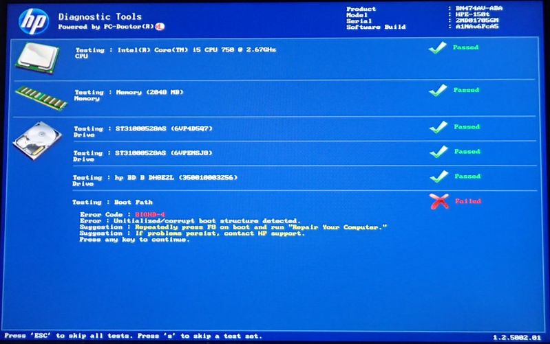

The hard drive tests are OK but the Boot Path test fails, 'Unitialized/corrupt boot structure detected' (see attached).  The suggested fix, (Repeatedly press F8 on boot and run "Repair Your Computer"), attempts to 'repair' but freez's a short time later (~5 seconds) and shutsdown.
attempts to fix the boot path but fails.attempts to fix the boot path but fails.
f9_diag_testsf9_diag_tests
Any advice on fixing the boot path problem?
