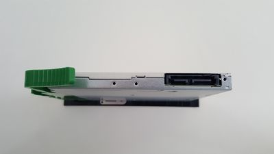

Now having an issue connecting the DVD-drive to the PSU and main board.
The connector of the DVD-drive looks like the connector that comes with a DVD-drive you find in notebooks.
The PSU has no connection for this kind of DVD-drive.

This is what the back of the DVD-drive looks like:
The connection on mainboard side has 2 exits, 1 goes to the right (larger) connection of the DVD-drive. The other one is attached to the PC chassis (grounding):
This is the original HP PSU, this smaller connector was connected to the left smaller connection of the DVD drive:
So I guess I only need something to get the DVD-powered, because data connection should be ok because it is already connected to the mainboard.
Am I right?

If you are using a conventional desktop power supply and the SATA cable to the motherboard is a regular SATA connector on the motherboard, it looks as though this would solve the problem
https://www.amazon.com/StarTech-6-Inch-Slimline-Adapter-SLSATAADAP6/dp/B009JXKQ9O/ref=pd_sim_147_1?_...

Hi TheOldMan, I'll stick with the adapter I posted earlier. I only need the connection from the slim sata connection on the DVD-drive to the standard SATA connection that comes from the PSU.
Many thanks for your help and support!
@TimePieces,
You are correct, that is all you actually need.  Can you please send the link to that adapter.  It looks cleaner in style than what I did link, but the functionality is the same.
