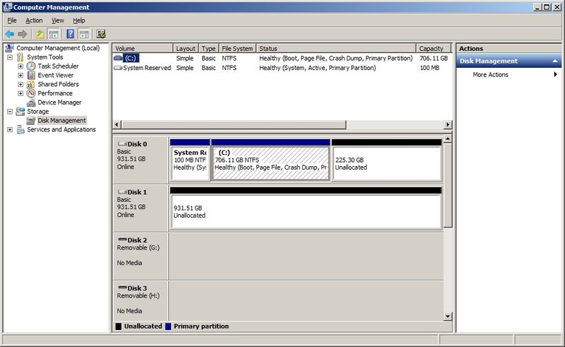

Well, I've made a little progress. At least, I think I might know what the problem is.
I downloaded a copy of the W10 installation software and burned it to a DVD, as you suggested. Then I disconnected the HDD, connected the SSD and tried to install W10, but W10 didn't see the SSD either. So as a last resort, I went into the Advanced Settings of the BIOS and changed the SATA Controller Mode from RAID to AHCI. When I rebooted, the W10 install procedure detected the SSD and I was able to install W10 on the SSD.
I'm a little out of my depth, technically speaking, but could it be that the BIOS firmware was "hiding" the SSD from Windows when it was in RAID mode, so it would have exclusive use of it in a RAID setup, to support redundancy? I don't really know much about the differences between IDE, RAID and AHCI, so I'm just guessing.
Anyway, I still have a problem, because if I disconnect the SSD, reconnect the HDD and try to boot W7, it only boots properly if I have it set to RAID mode. The SSD still doesn't appear in Storage Management, even though it's been formatted now. And I get an error if I set the controller mode to IDE or AHCI. So it seems that I can only boot from the HDD in RAID mode, and I can only boot from the SSD in IDE or AHCI mode.
This wouldn't matter if I just wanted to do a clean install of W10 (or W7), but I'd like to migrate my W7 install, along with all the apps I've installed over the years, to the SSD, so I won't have to reinstall all my apps. Plus I could later upgrade to W10 for free (It seems Microsoft still offers free upgrades from W7 or W8), but if I start with a clean install of W10, I'll have to buy a license. That might be the only solution, though.
