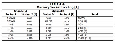

Use compressed air to blow any dust out before removing the memory chips,  With the system unplugged from the wall remove all memory chips and insert your first chip into the black socket #1 as described starting on Page 3-4 of the following document
http://h10032.www1.hp.com/ctg/Manual/c01549447.pdf
turn the system on and look for any error messages as described quote
If an incompatible memory module is detected the NUM LOCK will blink for a short period of
time during POST and an error message may or may not be displayed before the system hangs.
If the new stick of memory works then unplug  and add the remaining.  Channel A is the set of black sockets
