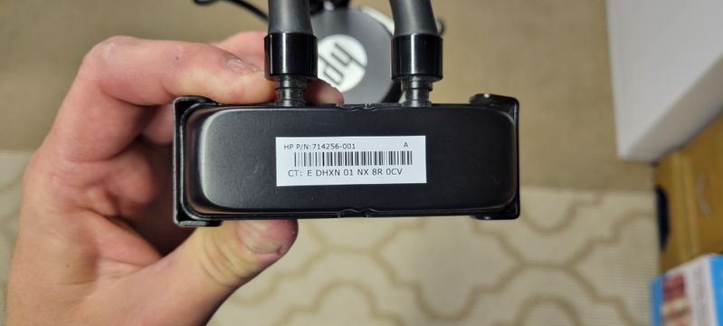

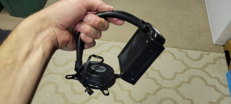

My HP ENVY Phoenix 810-430qe system is going on 9 years in a few months. I have an Intel I7-4790 processor that was previously paired with a Asetek 714256-001 liquid-to-air cooler. Unfortunately the pump must be wearing out as every 30 seconds or so a very loud crackling is heard that intensifies in volume and speed until it suddenly stops making noise all together, but then not long after it repeats this process over and over again, all day long.
I "downgraded" and purchased an Intel E97379-003 heatsink/fan. This heatsink normally attaches to the motherboard with those plastic push pins that everyone hates.
Unfortunately my motherboard does not have sufficient holes for this to work, as there are "nutserts" in the motherboard that appear to be non-removable and molded into the plastic, that formerly secured the water pump for the Asetek 714256-001 liquid-to-air cooler.
I currently have the Intel heatsink/fan somewhat "jerry rigged" on my processor, using a combination of the screws from the Asetek 714256-001 cooler and some washers to ensure that it fits snuggly against the processor.
